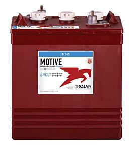

Trojan T145 6 Volt, 260 AH Deep Cycle Battery

T-145 260 Amp-Hour Deep Cycle Battery, 6 volts.
Shipping Note: This item must ship by truck freight. You must email us for a shipping quote or call us at 800-383-0195 to get actual shipping costs.
This is the 260 amp-hour, 6-volt deep cycle battery from Trojan, in the popular "Golf Car" (GC2H) size. These can be used in RV's, homes, cabins and most renewable energy systems.
Specifications
  • 6 Volts
  • 260 Amp-hours at the 20 hour rate
  • Dimensions: 10.375"L x 7.125"W x 11.625"H
  • Weight: 72 pounds
  • BCI Group Size: GC2H
Warranty: 1 year
