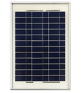

Ameresco BSP10-12 BSP Series 10 Watt Solar Panel
The BSP line of rugged, outdoor solar modules offer efficient solar cell technology combined with industrial design and quality construction. The impact resistant glass surface and robust anodized aluminum frame mount to our line of optional pole mount brackets.
Power from our solar modules is delivered through our integrated UV resistant cable and weatherproof junction box. BSP Series solar modules are suited for remote telemetry, SCADA, security, monitoring, fence charger, gate opener, intelligent traffic, and general battery charging applications.
Electrical Specifications:
  • Maximum Power (Pmax): 10 Watts
  • Voltage at Pmax (Vmp): 17.3 Volts
  • Current at Pmax (Imp): 0.58 Amps
  • Short-Circuit Current (Isc): 0.66 Amps
  • Open-Circuit Voltage (Voc): 21.3 Volts
Length: 16.5 Inches
Width: 10.7 Inches
Thickness: 1.31 Inches
