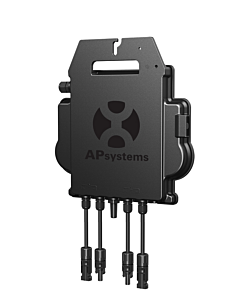

APsystems DS3-L-NA Dual Microinverter - 768VA - 118211
The APsystems DS3-L-NA Dual Microinverter (118211) is a high-efficiency microinverter designed for residential solar applications in North America. Delivering up to 768VA AC output power, the DS3-L-NA supports two solar modules with independent MPPT tracking, helping maximize energy harvest and optimize system performance throughout the day.
Engineered for compatibility with today's higher-powered solar modules, the DS3-L-NA utilizes APsystems' advanced dual-module architecture to provide reliable energy conversion and increased design flexibility. Independent MPPT channels allow each module to operate at its maximum power point, reducing the impact of shading, soiling, and module mismatch.
Integrated Zigbee communication enables seamless connectivity with APsystems Energy Communication Units (ECUs), providing module-level monitoring through the APsystems EMA platform. With a rugged NEMA 6 enclosure and a 25-year warranty, the DS3-L-NA is built for long-term reliability in demanding outdoor environments.
  • Dual-module microinverter supporting two PV modules
  • 768VA maximum continuous AC output
  • Two independent MPPT channels
  • Module-level monitoring capability
  • High-efficiency energy conversion
  • Encrypted Zigbee wireless communication
  • Compatible with APsystems ECU monitoring devices
  • Rapid Shutdown compliant when installed according to APsystems requirements
  • Flexible system design and expansion
  • Outdoor-rated enclosure for long-term durability
  • Designed for North American grid requirements
  • Product Type Dual Microinverter
  • Maximum Continuous AC Output Power 768VA
  • Recommended PV Module Power (STC) Range 265Wp-570Wp+
  • Peak Power Tracking Voltage 28V-45V
  • Operating Voltage Range 26V-60V
  • Maximum Input Voltage 60V
  • Maximum Input Current 18A x 2
  • Maximum input short circuit current 22.5A per input
  • Communication Zigbee
  • Operating Temperature -40°F to 149°F (-40°C to 65°C)
  • Dimensions 10.3 x 8.6 x 1.6 in (263 x 218 x 41.2 mm)
  • Weight 5.7 lbs (2.7 kg)
