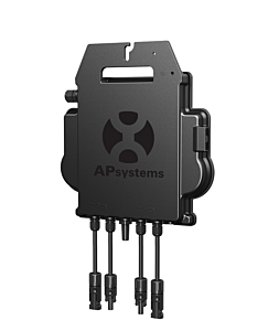

APsystems DS3-NA Dual Microinverter - 880VA - 117211
The APsystems DS3-NA Dual Microinverter (117211) is a high-performance dual-module microinverter designed for residential solar installations in North America. Delivering up to 880VA AC output power, the DS3-NA supports two photovoltaic modules with independent MPPT tracking, maximizing energy harvest and improving system performance in varying irradiance and shading conditions.
Built on APsystems' advanced microinverter platform, the DS3-NA provides enhanced power density, faster installation, and improved reliability compared to traditional string inverter systems. Independent MPPT channels allow each solar module to operate at its optimal power point, helping increase overall energy production while providing greater design flexibility.
The DS3-NA features encrypted Zigbee communication for seamless integration with APsystems Energy Communication Units (ECUs), enabling module-level monitoring and performance tracking through the APsystems EMA platform. Its rugged outdoor-rated enclosure is designed to withstand demanding environmental conditions while delivering long-term reliability.
