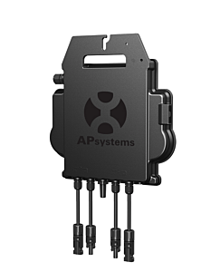

The APsystems DS3-S-NA Dual Microinverter (119001) is a compact and efficient dual-module microinverter designed for residential solar installations. With 640VA AC output power, the DS3-S-NA supports two solar modules and features independent MPPT tracking to maximize energy production from each module.
The dual-input design allows installers to connect two modules to a single microinverter while maintaining module-level optimization and monitoring. Independent MPPT channels help improve energy harvest by minimizing losses caused by shading, module mismatch, and varying roof conditions.
The DS3-S-NA incorporates APsystems' encrypted Zigbee communication technology, enabling seamless integration with APsystems ECUs for module-level monitoring through the EMA platform. Its durable NEMA 6 enclosure and fanless design provide reliable performance in a wide range of environmental conditions.
