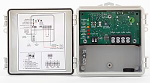

The Aquatec APC-30-250 is designed specifically to be an interface between a photovoltaic array, and the Aquatec SWP series submersible pumps. It is a solidstate power converter that optimizes and protects the solar well pump. The controller automatically extends pump run time by the use of current boosting, and provides protection from excessive Voltage and Current, as well as dry-running.
APC-30-250 Specifications:
- Max Load Power: 250 Watts
- Max input open circuit Voltage: 48 Volts DC
- Max Regulated Output Voltage: 30 Volts
- Max Load Current: 5 Amps DC
- Dimensions: 6.55" x 6.13" x 3.75"
