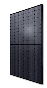

AXITEC AC-360MH/120VB
The power modules with half-cel technology have a lower cell resistance and thus a higher performance than full-cell solar modules.
AC-360MH/120VB specifications:
  • Nominal power: 360 Watts
  • Number of cells: 120
  • Vmp: 34.0 Volts
  • Voc: 40.5 Volts
  • Imp: 10.59 Amps
  • Isc: 11.35 Amps
  • Module efficiency: 19.76%
  • Dimensions (inches): 69.09" x 40.87" x 1.38"
  • Dimensions (mm): 1755 x 1038 x 35
  • Weight: 43.0 lbs (18.2 kg)
15 years manufactures's guarantee on 90% of the nominal performance
25 years manufactures's guarantee on 85% of the nominal performance
