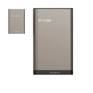

Canadian Solar EP Cube Lite System 6.6 kWh
This Energy Storage System can only ship via freight truck. It can NOT ship via UPS or USPS. Please email us or give us a call if you have any questions.
The Canadian Solar EP Cube Lite is a groundbreaking addition to the home energy management landscape, offering homeowners an accessible and efficient grid-tied energy storage solution. With a starting capacity of 6.6 kWh, expandable up to 19.9 kWh, it's designed to cater to various energy needs and budgets. Notable for its ease of expansion to the full-featured EP Cube, it represents a significant step towards democratizing energy storage, making sustainable living more attainable for a wider audience.
Innovatively designed with an integrated hybrid inverter and modular batteries, each component is lightweight (about 70 lbs), facilitating swift and cost-effective installations—typically under 20 minutes. This feature not only simplifies the setup process but also significantly reduces installation costs. The EP Cube Lite is compatible with most existing PV systems, ensuring that homeowners can effortlessly integrate it into their current energy setups.
Key to the EP Cube Lite’s appeal is its optimization for time-of-use energy savings. It enables homeowners to maximize solar energy utilization, storing excess solar power generated during off-peak hours for use when energy costs peak. This smart energy management can substantially reduce electricity bills while supporting a greener lifestyle.
  • Integrated hybrid inverter Supports DC and AC input
  • Scalable from 6.6 to 19.9 kWh Easy to transport and install
  • 3 to 7.6 kW output power Remote monitoring
  • 10-year warranty Energy retention > 80%
