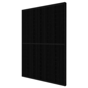

Canadian Solar TOPHiKu6 Specifications
  • Nominal Power: 450 Watts
  • Cell Type: TOPCon cells
  • Cell Arrangement: 108[2x(9x6)]
  • Vmp: 33.0 Volts
  • Imp: 13.66 Amps
  • Voc: 38.9 Volts
  • Isc: 14.55 Amps
  • Panel Efficiency: 22.0%
  • Dimensions: 70.9" x 44.6" x 1.38" (35mm)
  • Weight: 50.7 lbs
