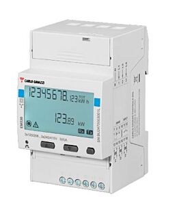

Carlo Gavazzi EM530 Split phase or 3 phase Energy Meter with external Split core CTs 250 amp 2x
For US applications System less than 65A please look at the EM540 meter.
For systems greater than 250 amps you will need to purchase larger CTs. Please refer to the manufacture manual for CT options.
Power Meter (EM530)
A power meter from Carlo Gavazzi unlocks full suite of Energy Management Solutions, and makes your Pulsar Plus future-ready for all software upgrades without needing additional hardware. Enjoy enhanced savings and cleaner energy use, with solar EV charging and dynamic load balancing features.
- Voltage inputs up to 415 VL-L AC, self-powered Used in Split phase 120/240 vac or three phase 208 Vac system
- Current and voltage THD (up to 15th harmonic)
- Energy measurements (imported/exported): total kWh, kvarh, kVAh; partial kWh, kvarh, kVAh. Total kWh by phase
- Run hour meters (both imported and exported energy: 8+2 DGT). Total operating time
- EM530: Class 0.5S (kWh), class 2 (kvarh). Current inputs via 5A current transformers (max primary current 10,000A)
- Programmable display and slide show function
- RS485 Modbus output
