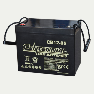

Centennial AGM batteries are a perfect representation of stable quality and high reliability batteries. Centennial's AGM sealed construction allows for the battery to provide long life cycles. At the same time, being a maintenance-free product with a low pressure ventilation system, makes it perfect for standby applications. The ability to deliver high currents without significant drops in voltage is what makes Centennial competitively exclusive in guaranteeing customer satisfaction.
CB12-85 Specifications:
  • Model number: CB12-85
  • Cells per battery: 6
  • Voltage: 12 Volts
  • Capacity: 85 Amp-hours @ 20 hour rate to 1.75V per cell
  • Max discharge current: 800 Amps (5 seconds)
  • Internal resistance: 5.5 miliohms
  • Recommended max charging current: 24 Amps
  • Self discharge: approximately 3% per month at 25°C
  • Terminal type: F11
  • Weight: 54.67 pounds (24.8 kg)
  • Dimensions (L x W x H): 10.24" x 6.65" x 8.27" inches. Total height with terminals: 8.46" inches
Warranty: 2 years free replacement; 5 years pro rated; 7 years total
