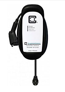

ClipperCreek’s HCS charging stations come in a variety of power levels, as hardwired and plug-in units, and with multiple pedestal mount options. Recent additions to the HCS product line include the HCS-60R and HCS-80R, ‘ruggedized’ versions of our most powerful HCS models, offering up to 64 Amp charging; and the ChargeGuard, a simple key-based access control option.
- Fast Charging - Up to 15.4kW of power to charge your vehicle quickly
- Quality - Technology that works for the life of your current plug-in vehicle and then some
- Convenient - 25 feet of charging cable for installation flexibility and superior vehicle reach
- Durable - Rugged, fully sealed NEMA 4 enclosure for installation anywhere
- Reliable - Backed by ClipperCreek’s exceptional warranty and outstanding customer service
Electrical Specifications:
- Certifications - ENERGY STAR, ETL, cETL Listed
- Service - 208V to 240V - 20A to 80A, single phase, 2 wire w/ground
- Charge Current Output Power - 208V to 240V-16A to 64A continuous (3.3kW to 15.4kW)
- Service Ground Monitor - Constantly checks for presence of proper safety ground
- Automatic Circuit Reclosure - After minor power faults
- Charge Circuit Interruption Device - Ground fault protection with fully automated self-test, eliminates manual user testing
Material Specifications:
- NEMA 14-50 Plug
- 25 foot charging cable
- Three year warranty
- Indoor/outdoor rated fully sealed (NEMA 4) enclosure
- Operating temperatures: -22°F to 122°F (-30°C to 50°C)
- Wall mount holster included
