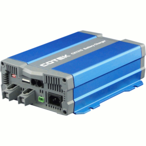

COTEK CX1225 12 Volt 25 Amp Battery Charger
CX1225 Features
  • Universal AC input with active PFC
  • Suitable for lead acid, Li-ion, Gel and AGM batteries
  • 3-stage charging mode
  • Dry contact for alarm
  • Support RS-232 communication protocol
  • Voltage temperature compensation2 stage fan speed control (sleep mode)
  • High efficiency and high reliability
  • Built-in battery rescue function
  • Built-in Engine Start Battery (ESB) output function
  • Single output support single battery
  • Protection: Short Circuit / Over Voltage / Over Temperature / Brown-out
  • Withstand 2G vibration test
  • CE approved
  • Accessory: Remote controller CR-1
