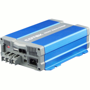

COTEK CX2440 24 Volt 40 Amp Battery Charger
CX2440 Features
  • Universal AC input with active PFC
  • Suitable for lead acid, Li-ion, Gel and AGM batteries
  • 3-stage charging mode
  • Dry contact for alarm
  • Support RS-232 communication protocol
  • Voltage temperature compensation2 stage fan speed control (sleep mode)
  • High efficiency and high reliability
  • Built-in battery rescue function
  • Built-in Engine Start Battery (ESB) output function
  • Single output support single battery
  • Protection: Short Circuit / Over Voltage / Over Temperature / Brown-out
  • Withstand 2G vibration test
  • CE approved
  • Accessory: Remote controller CR-1
CX2440 Specification:
 Battery Type  Lead Acid / Li-ion / Gel / AGM
 Output voltage  24V
 Standard Boost Charge Voltage  28.8V / 29.4V(select by S1-1)
 Standard Float Charge Voltage  27.6V / 27.0V(select by S1-2)
 Main Rated Current 40A
 input voltage Range  90~264VAC
 Peak Efficiency at Full Load  90%
Operating Temperature -20°C to 50°C (-4°F to 122°)
Storage Temperature  -40°C to 85°C (-40°F to 185°)
Safety CE
Dimensions 8.39" x 3.01" x 12.29"
Weight 8.598 lbs.
2 Year Warranty
