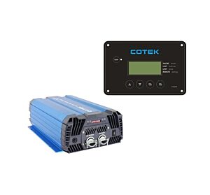

COTEK SC1200-124-Combo Inverter Charger
The Cotek SC1200-124 is a 1200 Watt, 24 Volt pure sine wave inverter charger. This bi-directional inverter is versatile with 5 in 1 operating modes, capable of integrating power from both AC and DC sources for larger loads. It features a three-stage charging function and operates efficiently within a wide temperature range of -20°C to 40°C. The inverter's key specifications include an input voltage range of 21.0 to 33.0 VDC, output voltage of 120 VAC, and a maximum efficiency of 89%. Its dimensions are 9.88" x 4.57" x 15.19", and it weighs 10.03 lbs. The Cotek SC1200-124 comes with a 2-year warranty from the date of purchase, ensuring reliability and customer satisfaction.
The Cotek CR-20C Remote Control is an ideal accessory to enhance the functionality and user experience of the Cotek SC-Series inverter charger. This remote control allows for convenient operation and monitoring of the inverter charger, making it easier to manage and adjust settings remotely. Pairing the Cotek SC-Series with the CR-20C Remote Control creates a synergistic combination, providing users with an efficient, user-friendly solar power management system. This combo offers an advanced solution for solar energy systems, ensuring ease of use and improved control.
SC1200-124 Features and Specifications:
  • Bi-directional inverter and charger
  • 3 stage charging function
  • Output Power 1200 Watt
  • Input Voltage: 24VDC
  • Input Voltage Range: 21.0 ~ 33.0 VDC
  • Output Voltage: 120 VAC
  • Output Frequency: 60 Hz
  • Max. Efficiency: 90%
  • Wide Working temperature range: -20oC ~ 40oC
  • Dimensions: 9.88" x 4.57" x 15.19"
  • Weight: 10.03 lbs
  • Warranty: 2 years
