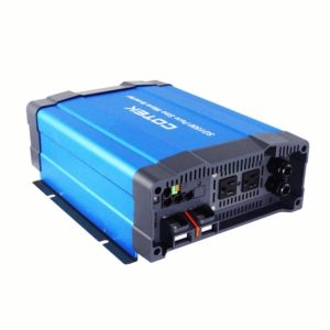

COTEK SD1500-148 1500 Watt 48 Volt Pure Sine Wave Hardwire Inverter
SD1500-148 HW
$582.00
Note: This product is set up to be hard wired only, Pictures do not display hard wired inverter setup. The third picture shows a SD3500 inverter that is hard wired only.
COTEK SD1500-148 Hardwired & UL Listed Inverter
- Parallel redundancy design for power expansion
- Multiple industrial applications that create 1Ф3W/3Ф4Wpower systems
- Automatic master mechanism to eliminate single point failure and optimize reliability
- Built-in ATS and AC circuit breaker
- RS-232 communicatio
- Input & output fully isolation
- Output voltage/power saving mode select able by DIP switch or remote control (CR-10)
- Input Protection: Reverse Polarity (Fuse) / Under Voltage/Over Voltage
- Output Protection: Short Circuit /Overload /Over Temperature /Over Voltage
