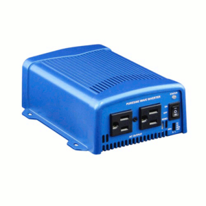

COTEK SE200-124 200 Watt 24 Volt Pure Sine Wave Inverter
SE200-124
$209.00
COTEK SE200-124 Pure Sine Wave Inverter
  • Power ON/OFF remote control (Green Terminal)
  • Wide input range:10~16VDC (112/212),20~32VDC(124/224)
  • Wide operating temperature: -20 C ~ 60  C
  • Output frequency (50/60Hz) selectable by DIP switch
  • Output voltage/power saving mode selectable
  • Input Protection: Reverse Polarity (Fuse)/Under Voltage/Over Voltage
  • Output Protection: Short Circuit/Overload/Over Temperature
  • E13/CE/FCC approved
SE200-124 Specifications:
Output Frequency 60 Hz
Continuous Power 200 Watts
Surge Power 250 VA (3Sec.)
Input Voltage 24 Volts DC
Input Voltage Range 20.0 to 32.0 Volts DC
Peak Efficiency at Full Load 91%
Storage Temp. Range -30°C to 70°C (-22°F to 154°)
Dimensions 5.91" x 2.68" x 7.36"
Weight 3.53 lbs.
Warranty: 2 years
SKUSE200-124
