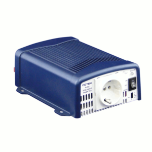

COTEK SE350-124 350 Watt 24 Volt Pure Sine Wave Inverter
SE350-124
Note: This model is no longer available. Please se the SE400-124 as an alternative.
  • Power ON/OFF remote control (Green Terminal)
  • Wide input range:10~16VDC (112/212),20~32VDC(124/224)
  • Wide operating temperature: -20 C ~ 60  C
  • Output frequency (50/60Hz) selectable by DIP switch
  • Output voltage/power saving mode selectable
  • Input Protection: Reverse Polarity (Fuse)/Under Voltage/Over Voltage
  • Output Protection: Short Circuit/Overload/Over Temperature
  • E13/CE/FCC approved
SE350-124 Specifications:
Output Frequency 60 Hz
Continuous Power 350 Watts
Surge Power 700 VA
Input Voltage 24 Volts DC
Input Voltage Range 20.0 to 32.0 Volts DC
Peak Efficiency at Full Load 88%
Storage Temp. Range -30°C to 70°C (-22°F to 154°)
Dimensions 5.91" x 2.669" x 7.375"
Weight 3.53 lbs.
Warranty: 2 years
SKUSE350-124
