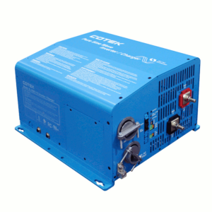

COTEK SL2000-112 Pure Sine Wave Inverter
The Cotek SL2000 inverter/charger is a pure sine wave inverter designed for mobile and renewable energy applications. This powerful charger can be used to recharge your batteries by plugging into 120-volt AC power from either from the grid or a generator. Cotek has integrated several advanced protection features including:
  • DC input over/under voltage protection
  • Internal over temperature, battery over temperature and heat sink over temperature
  • InverterAC output overload protectionInverter
  • AC output short circuit protection
  • AC input short circuit protection: Breaker (50Amp)
  • AC input under/over voltage protection
The SL2000 is easy to install and is a good cost-effective option for smaller off-grid and mobile power systems
  • All in one design: Bi-direction inverter and charger
  • 4 stage charging function with Max. 100A
  • Up to 12KW AC bypass capability (thru 2 legs , 50 Amp each)
  • Intelligent software for power management: Power sharing and generator function
  • Fan controls by load and temperature
  • -20C~40C full load operation without derating
  • UL458 with marine supplement , CSA 22.2 , FCC approved
  • Compact design (2000W @ 17.6 kg)
SL2000-112 Specifications:
Output Frequency 60 Hz
Continuous Power 2000 Watts
Surge Power 3400 VA
Input Voltage 12 Volts DC
Input Voltage Range 9.0 to 17.0 Volts DC
Dimensions 12.64" x 7.99" x 13.74"
Weight 38.71 lbs.
