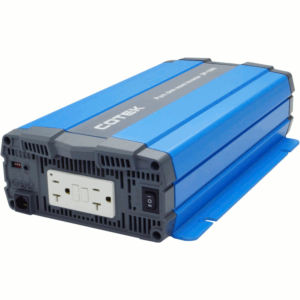

COTEK SP1000-148 1000 Watt 48 Volt Pure Sine Wave Inverter
COTEK SP1000-148 Pure Sine Wave Inverter
- Total power output: 1000 Watts
- Pure sine wave output
- Power ON / OFF remote control (Green Terminal)
- Remote controller CR-8 / CR-16 (optional)
- Input & Output fully isolation
- Temperature & Load controlled cooling fan
- Built in advance microprocessor to provide friendly interface
- Output frequency 50 / 60 Hz selectable by DIP switch
- Output voltage DIP switch selectable
- Adjustable power saving mode by variable resister
- 3-color LED status indicators
- Input protection: Reverse Polarity (Fuse) / Under Voltage / Over Voltage
- Output protection: Short Circuit / Overload / Over Temperature
- E-13 / UL / CE / FCC approve
SP1000-148 Specifications:
Output Voltage | 120 Volts AC, +/- 5% |
Output Frequency | 60 Hz |
Output Waveform | Pure Sine Wave |
Continuous Power | 1000 Watts |
Surge Power | 1750 VA |
Input Voltage | 48 Volts DC |
Input Voltage Range | 42.0 to 66.0 Volts DC |
Peak Efficiency at Full Load | 93% |
Normal Operating Temp. Range | -20°C to 60°C (-4°F to 140°) |
Full Load Operating Temp. Range | -20°C to 40°C (-4°F to 104°) |
Dimensions | 7.87" x 3.27" x 14.65" |
Weight | 7.19 lbs. |
Warranty: 2 years
SKU | SP1000-148 |
