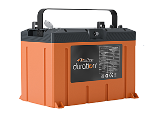

Deka Duration DD100-12 12V 100Ah LiFePO4 Battery
DD100-12
$767.96
Deka Duration DD Series 12V LiFePO4 Batteries
The Deka Duration DD Series 12V LiFePO4 batteries deliver advanced lithium iron phosphate (LiFePO4) technology for reliable, long-lasting energy storage in solar and backup power systems. Designed for deep-cycle performance, these batteries provide higher efficiency, longer cycle life, and significantly reduced weight compared to traditional lead-acid alternatives.
Key Features:
  • LiFePO4 chemistry for enhanced safety and long cycle life
  • Lightweight design compared to lead-acid batteries
  • High efficiency with fast charging capability
  • Deep-cycle performance for solar and backup systems
  • Integrated Battery Management System (BMS) for protection and performance
Applications
  • Off-grid solar systems
  • Backup power systems
  • Mobile and remote power applications
Specifications
  • Nominal Voltage: 12V
  • Capacity: 100Ah
  • Recommended Charge Current: 50A
  • Recommended Discharge Current: 50A
  • Max Charge: 100A
  • Max Discharge: 150A
  • Surge Current Limit: 500A for 3S
  • Operational Temperature: -4° to 140°F (-20° to 60°C)
  • Discharge Temperature: -4° to 140°F (-20° to 60°C)
  • Non Heated Model Charge Temperature: 32° to 140°F (0° to 60°C)
  • Terminal Type and Hole: Threaded Insert M8 Bolt
  • Certifications: UN38.3, UL 1973 Recognized Component, IEC62619, CE
  • Weight: 26 lb
  • Dimensions: 12.1" x 6.6" x 8.3"
SKUDD100-12
