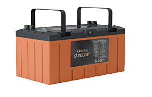

Deka Duration DD300-12H 12V 300Ah LiFePO4 Heated Battery
DD300-12H Heated
$2,102.55
Deka Duration DD Series 12V LiFePO4 Batteries
The Deka Duration DD Series 12V LiFePO4 batteries deliver advanced lithium iron phosphate (LiFePO4) technology for reliable, long-lasting energy storage in solar and backup power systems. Designed for deep-cycle performance, these batteries provide higher efficiency, longer cycle life, and significantly reduced weight compared to traditional lead-acid alternatives.
Key Features:
  • LiFePO4 chemistry for enhanced safety and long cycle life
  • Lightweight design compared to lead-acid batteries
  • High efficiency with fast charging capability
  • Deep-cycle performance for solar and backup systems
  • Integrated Battery Management System (BMS) for protection and performance
Applications
  • Off-grid solar systems
  • Backup power systems
  • Mobile and remote power applications
Specifications
  • Nominal Voltage: 12V
  • Capacity: 100Ah
  • Recommended Charge Current: 150A
  • Recommended Discharge Current: 150A
  • Max Charge: 300A
  • Max Discharge: 200A
  • Surge Current Limit: 1000A for 3S
  • Operational Temperature: -4° to 140°F (-20° to 60°C)
  • Discharge Temperature: -4° to 140°F (-20° to 60°C)
  • Heated Model Charge Temperature: -4° to 140°F (-20° to 60°C)
  • Terminal Type and Hole: Threaded Insert M8 Bolt
  • Certifications: UN38.3, UL 1973 Recognized Component, IEC62619, CE
  • Weight: 81.8 lb
  • Dimensions: 19.7" x 10.4 x 9.2"
SKUDD300-12H Heated
