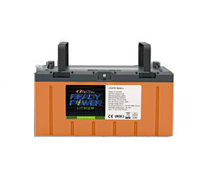

The Deka Ready Power DRP100-24 is a high-performance 24V 100Ah lithium iron phosphate (LiFePO4) battery engineered by East Penn Manufacturing for reliable energy storage in solar, backup, and off-grid applications. This monobloc battery combines advanced lithium chemistry with a rugged, maintenance-free design for long-lasting performance.
Designed for deep cycle use, the DRP100-24 delivers consistent power with excellent efficiency and significantly longer cycle life compared to traditional lead-acid batteries. Its integrated Battery Management System (BMS) protects against overcharge, over-discharge, short circuit, and temperature extremes, ensuring safe and dependable operation.
Specifications
  • Nominal Voltage: 24V
  • Capacity: 100Ah
  • Recommended Charge Current: 50A
  • Recommended Discharge Current: 100A
  • Max Charge: 100A
  • Max Discharge: 120A
  • Surge Current Limit: 500A for 3S
  • Operational Temperature: -4° to 140°F (-20° to 60°C)
  • Discharge Temperature: -4° to 140°F (-20° to 60°C)
  • Charge Temperature: -4° to 140°F (-20° to 60°C)
  • Terminal Type and Hole: Threaded Insert M8 Bolt
  • Certifications: UN38.3, UL 1973 Recognized Component, CE
  • Weight: 50 lb
  • Dimensions: 19.1" x 6.8" x 9.2"
