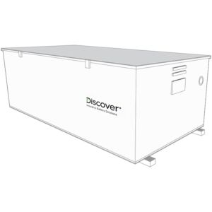

Discover NEMA 3R Battery Enclosure: A versatile and durable solution for your energy storage needs.
If you are looking for a reliable and convenient way to store your solar energy, look no further than the Discover NEMA 3R Battery Enclosure. This trunk-shaped enclosure is designed to meet the NEMA 3R standards for outdoor use, protecting your batteries from rain, snow, dust, and insects. It can accommodate up to 20 kWh of Discover AES LiFePO4 batteries (42-48-6650) or up to 18.48 kWh of Discover DLP batteries (DLP-GC2-48V or DLP-GC2-24V), making it compatible with the UL 9540:2020 Ed.2 limit for residential ESS.
The Discover NEMA 3R Battery Enclosure is not only sturdy, but also smart. It features a powder-coated white aluminum exterior that reflects solar heat and reduces thermal loading. It also has louvered ports on both sides that allow for natural ventilation and cooling in hot climates. For colder climates, you can add up to 2 inches of rigid insulation inside the enclosure to keep your batteries warm and efficient.
The Discover NEMA 3R Battery Enclosure is easy to install and customize. It has pre-drilled knockouts of various sizes for different DC cable and network cabling configurations. It also has lifting handles and lockable clasps for easy transportation and security. You can secure the enclosure to a cement pad for extra stability.
The Discover NEMA 3R Battery Enclosure is a cost-effective and eco-friendly option for your energy storage needs. Each enclosure weighs only 68 lbs (30.85 kg), making it lightweight and portable.
With the Discover NEMA 3R Battery Enclosure, you can enjoy the benefits of solar energy without worrying about the weather, temperature, or theft. Order yours today and discover the difference!
Features and Specifications:
  • Part number: 950-0043
  • Manufactured to NEMA 3R specifications
  • Enclosure dimensions: 16.425" x 48.25" x 24.25" inches
  • Weight: 68 pounds
  • Stainless steel pad lock hasp & two pad lockable draw latches
