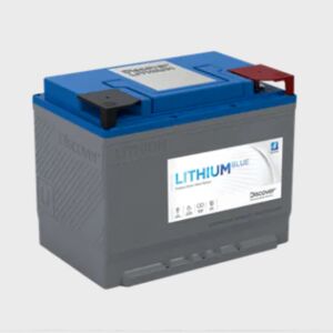

Discover DLB-G24-24V Lithium Blue 24V 45Ah Battery With BMS & Bluetooth
Discover Energy 1.17kWh 24VDC Lithium Blue Battery
Notice: DLB batteries are not designed to be series configured for cyclic applications. Should your application require a higher nominal voltage than the nominal battery voltage specified please consult with our sales/engineering team for alternative product recommendations.
Discover Lithium Blue LiFePO4 premium Series batteries offer BMS controlled safety, long life, lightning fast charging performance and real-time Bluetooth access to battery state of charge, voltage, current, temperature status. Lithium Blue batteries reflect Discover’s design for excellence philosophy, incorporating suitcase style carrying handles, terminal protection and field serviceable fuses. Lithium Blue batteries are safe, easy to install and parallel for more capacity.
Lithium Blue LiFePO4 batteries feature a Discover Bluetooth App that gives real-time access to battery State of Charge, voltage, operating current, temperature, and other operating information.
DLB-G24-24V Specifications:
- Group Size (BCI): Low G24R
- Chemistry: LiFePO4
- Open Circuit Voltage: 25.6 Volts
- Nominal Energy: 1.17 kWh
- Rated Capacity: 45 Amp-hours
- Maximum Voltage: 29.2 Volts
- Minimum Voltage: 24.0 Volts
- Maximum Continuous Charge Current: 45 Amps DC
- Maximum Continuous Discharge Current: 45 Amps DC
- Self Discharge Rate: <3% per month
- Charge Temperature Range: 0°C to 45°C (32°F to 113°F)
- Discharge Temperature Range: -20°C to 50°C (-4°F to 120°F)
- Storage Temperature Range: -10°C to 30°C (14°F to 86°F)
- Length: 10.3 inches
- Width: 6.9 inches
- Total Height: 8.3 inches
- Weight: 26.5 lbs. (11.8 kg)
