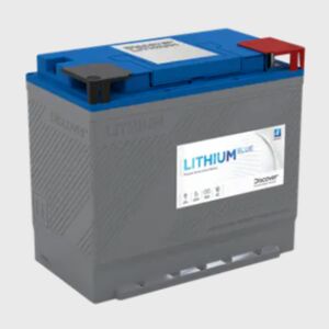

Discover Lithium Blue LiFePO4 premium Series batteries offer BMS controlled safety, long life, lightning fast charging performance and real-time Bluetooth access to battery state of charge, voltage, current, temperature status. Lithium Blue batteries reflect Discover’s design for excellence philosophy, incorporating suitcase style carrying handles, terminal protection and field serviceable fuses. Lithium Blue batteries are safe, easy to install and parallel for more capacity.
Lithium Blue LiFePO4 batteries feature a Discover Bluetooth App that gives real-time access to battery State of Charge, voltage, operating current, temperature, and other operating information.
