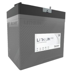

Discover Energy 1.54kWh 24VDC Lithium Pro Battery
Discover Lithium PRO LiFePO4 battery models are purpose built to replace and fit the standard groupings of BCI 6V, 8V and 12V (GC) batteries. Used in renewable energy, work vehicles, utility electric vehicles, golf-carts, floor care machines, and aerial work platforms, Lithium PRO batteries incorporate a proprietary high-current BMS that delivers superior peak power along with lightning fast 1C continuous charge and discharge rates, plus they feature COLD CHARGE functionality allowing for cold temperature charging to begin from -20⁰C / -4⁰F. Independently tested to the highest safety, performance and transportation standards, a single battery will do the work of many lead-acid batteries and, unlike lead-acid batteries can be continuously operated in a partial state of charge (PSOC) without degrading performance.
Lithium PRO LiFePO4 batteries are maintenance-free, deliver 100% depth of discharge, 99% round-trip efficiency (RTE), and deliver up to 10x the life of deep-cycle lead-acid batteries. Lithium PRO batteries include an at-a-glance status LED and a LYNK Port that enables paralleled batteries to be connected together and for the BMS to communicate with a LYNK Gateway for real-time optimized closed-loop communication with the world's best known off-grid inverters, chargers, system controls, SoC displays, and telematics. Simple plug-and-play installation and the capability to be scaled to over 30 kWh can make a good system great.
DLP-GC2-24V Specifications:
  • Group Size (BCI): GC2
  • Chemistry: LiFePO4
  • Open Circuit Voltage: 25.6 Volts
  • Nominal Energy: 1.54 kWh
  • Rated Capacity: 60 Amp-hours
  • Maximum Voltage: 29.2 Volts
  • Minimum Voltage: 20.0 Volts
  • Maximum Continuous Charge Current: 60 Amps DC
  • Maximum Continuous Discharge Current: 60 Amps DC
  • Self Discharge Rate: <3% per month
  • Charge Temperature Range: -20°C to 45°C (-4°F to 113°F)
  • Discharge Temperature Range: -20°C to 50°C (-4°F to 120°F)
  • Storage Temperature Range: -10°C to 30°C (14°F to 86°F)
  • Length: 10.2 inches
  • Width: 7.1 inches
  • Total Height: 10.7 inches
  • Weight: 30.4 lbs. (13.8 kg)
Warranty: 4 years (7 years with registration)
