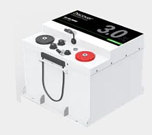

Discover Energy AES 2.92kWh / 48VDC LiFePO4 Solar Stationary Battery
NOTE: This battery must ship via freight truck. Please email us or call for the most accurate shipping estimate.
Discover® Advanced Energy System (AES) LiFePO4 Lithium solar batteries offer bankable performance and the lowest cost of energy storage per kWh. AES LiFePO4 Lithium batteries are manufactured with the highest-grade LiFePO4 cells and feature a proprietary high peak surge and transient voltage hardened BMS that delivers superior peak power, lightning fast charge and discharge rates and LYNK Solar Gateway functionality for plug-and-play closed loop integration with the worlds best known off-grid inverters and chargers turning a good system into a great one.
44-48-3000 Specifications:
  • Nominal Capacity: 2,920 Wh
  • Usable DoD: 100%
  • Rated Ah Capacity(1C): 57
  • Voltage: 48
  • Nominal Voltage: 48
  • Charge Voltage: 54
  • Maximum Voltage: 58.4
  • Minimum Voltage: 44.8
  • Charge Temperature: Min: 32oF / Max: 113oF
  • Discharge Temperature: Min: -4oF / Max: 122oF
  • Storage Temperature: Min: 14oF / Max: 86oF
  • Maximum Continuous Charge Current: 57 Adc
  • Maximum Continuous Discharge Current: 57 Adc
  • Maximum Peak Current: 219 Adc
  • Dimensions:(L x W x H): 13.0" x 13.3" x 10.1"
  • Weight: 88
  • Cell Chemistry: LiFePO
  • Warranty: 4 years(10 years with registration)
