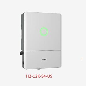

Discover Energy Systems H2 HV Split Phase Hybrid Inverter with MPPT
The Discover Energy Systems H2 HV Split Phase Hybrid Inverter with MPPT is a highly efficient and versatile solution designed for residential and small commercial solar installations. This hybrid inverter seamlessly integrates solar energy, battery storage, and grid power to optimize energy use and ensure uninterrupted power supply. The advanced Maximum Power Point Tracking (MPPT) technology ensures maximum efficiency by dynamically adjusting to the optimal power output of your solar panels.
Capable of handling high voltage battery systems, the H2 HV Split Phase Hybrid Inverter supports both grid-tied and off-grid applications, making it ideal for a wide range of energy setups. Its split phase design offers flexibility in power distribution, providing consistent 120/240V output that meets the demands of modern electrical systems.
The inverter’s user-friendly interface and remote monitoring capabilities allow for easy management and real-time tracking of system performance, ensuring that your solar setup is always operating at peak efficiency. With robust safety features, including advanced protection against overloads and short circuits, this inverter is built for long-term reliability and peace of mind.
  • 120/240V Split Phase Power
  • Parallel up to Four Inverters to 48.0 kW
  • Up to 4 MPPTs with 16A PV Input Per MPPT
  • AC Couple with Existing PV Solar Systems
  • 10-Year Warranty
  • Max. PV Array Power (Wp)@STC: 18000
  • Max. DC Voltage (V): 600
  • MPPT Voltage Range (V): 90-550
  • Nominal DC Voltage (V): 360
  • Number of MPPT: 4
  • Max. DC Input Current (A): 16/16/16/16
  • Max. DC Short Current (A): 19.2/19.2/19.2/19.2
  • PV Strings per MPPT: 1/1/1/1
  • Battery Type: LiFePO4
  • Battery Voltage Range (V): 85-450
  • Max. Charging/Discharging Current (A): 50
  • AC Nominal Power (W)@240Vac: 12000
  • Rated AC Current (A)@240Vac: 50.0
  • AC Nominal Power (W): 12000
  • Surge AC Power (VA): 14400,10s
  • Rated Output Voltage (V): 240/120
  • Rated Output Frequency (Hz): 60
  • Max. Efficiency: 97.6
  • Dimensions: 27.2 x 19.3 x 7.8 inch (690*490*198 mm)
  • Weight: 71 lbs (32kg)
