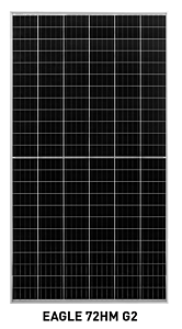

Eagle 72HM G2 JKM400M-72HL-V 400 Watt
The Jinko JKM400M-72HL-V Eagle G2 400 Watt Mono PERC solar panel delivers high-efficiency performance using advanced Diamond Cell technology. Featuring 144 half-cut monocrystalline PERC cells, this panel reduces power loss and boosts energy output in partial shade and high-temperature environments. With a robust anodized aluminum frame, it withstands heavy snow and wind loads, making it ideal for residential, commercial, or off-grid solar applications. Backed by a 10-year product warranty and a 25-year linear power warranty, the JKM400M-72HL-V ensures long-term reliability and energy savings.
Eagle 72HM G2 JKM400M-72HL-V Specifications
  • Nominal Power: 400 Watts
  • Cell Type: Mono PERC Diamond Cell
  • Cell Arrangement: 144(6x24)]
  • Vmp: 40.16 Volts
  • Imp: 9.96 Amps
  • Voc: 49.1 Volts
  • Isc: 10.61 Amps
  • Panel Efficiency: 22.3%
  • Dimensions: 79.06" x 39.45" x 1.57" (40mm)
  • Weight: 49.6 lbs
