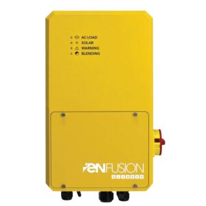

The Blender 2500 seamlessly blends energy between a solar array and the power grid. It is ideally suited for applications that require 24/7 or some nighttime operation, particularly in areas with high energy costs. The Blender represents a cost effective way to intelligently supplement solar power with controllable nighttime operation without the expense of adding batteries.
During full solar irradiance, the Blender will draw maximum power from the PV array. As cloud cover or impending darkness reduce the level of solar irradiance, the system automatically makes up the difference by drawing from the grid. Once it is dark, the system can draw all of its power from the grid. In high energy cost areas this allows for both power firming during the day and full nighttime operation while consuming as little power from the grid as possible.
