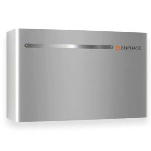

With Enphase storage, when the grid is down, you have power. And when the grid is up, you can save money. The Encharge storage system includes the Enphase Encharge Battery with integrated Enphase IQ microinverters. The Enphase IQ Envoy communication gateway measures PV production and home energy consumption. Using that data, the Encharge storage system senses when it is optimal to charge or discharge the battery so that energy is stored when it is abundant and used when scarce. Encharge storage systems are capable of providing backup power when an Enphase Enpower smart switch is installed at the site.
The Encharge 10 all-in-one AC-coupled storage system, comprised of three base Encharge 3 storage units, provides a total usable energy capacity of 10.1kWh and twelve embedded grid-forming microinverters. Connect multiple Encharge 10 storage systems to maximize backup potential for whole home backup.
