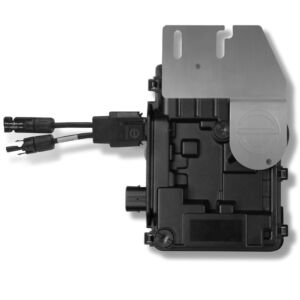

Enphase IQ 6+ Micro Inverter With MC4 DC Input Connectors
Designed for higher powered modules, the smart grid- ready Enphase IQ 6 Micro and Enphase IQ 6+ Micro are built on the sixth-generation platform and achieve the highest efficiency for module-level power electronics and reduced cost per watt. Part of the Enphase IQ System, the IQ 6 and IQ 6+ Micro integrate seamlessly with the Enphase IQ Envoy, Enphase IQ Battery, and the Enphase Enlighten monitoring and analysis software. The IQ 6 and IQ 6+ Micro are very reliable as they have fewer parts and undergo over 1 million hours of testing. Enphase provides an industry-leading warranty of up to 25 years.
IQ 6+ Features
  • For 60 and 72-cell PV modules
  • Max Output Power: 290 VA
  • Recommended PV module input power: 235-400+ W
  • MPPT Range: 27-45 V
  • 97.0% CEC Efficiency
  • CSA Listed Per UL 1741/IEEE1547
Easy to Install
  • Lightweight
  • Simple cable management
  • Built-in rapid shutdown (NEC 2014)
Productive
  • Optimized for high powered modules
  • Supports 60 and 72-cell modules
  • Maximizes energy production
Smart Grid Ready
  • Complies with fixed power factor, voltage and frequency ride-through requirements
  • Remotely updates to respond to changing grid requirements
  • Configurable for varying grid profiles
Mechanical Data
  • Dimensions (WxHxD): 219 mm x 191 mm x 37.9 mm (without bracket)
  • Dimensions (WxHxD): 8.62 in x 7.52 in x 1.49 in (without bracket)
  • Weight: 1.29 kg (2.84 lbs)
