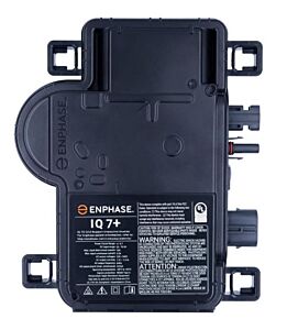

Enphase IQ 7 Plus Micro Inverter With MC4 DC Input Connectors
The smart-grid ready Enphase IQ 7 Microinverter series is built on the seventh-generation platform and achieves the highest efficiency for module-level power electronics. Its polymeric enclosure and revolutionary cabling system simplify installation.
- Optimized for high powered 60-cell & 72-cell modules
- Max Output Power: 290 VA
- Recommended PV module input power: 235-440+ W
- MPPT Range: 27V – 45V
- 97.5% CEC Efficiency
- Configurable for variable grid profiles like Hawaiian Electric Company (HECO) Rule 14H, California Rule 21, and others
Easy to Install
- Lightweight and simple
- Faster installation with improved, lighter two-wire cabling
- Built-in rapid shutdown compliant (NEC 2014 & 2017)
Productive and Reliable
- Optimized for high powered 60-cell and 72-cell modules
- More than a million hours of testing
- Class II double-insulated enclosure
- UL listed
Smart Grid Ready
- Complies with advanced grid support, voltage and frequency ride-through requirements
- Remotely updates to respond to changing grid requirements
- Configurable for varying grid profiles
- Meets CA Rule 21 (UL 1741-SA)
Mechanical Data
- Connector type: MC4
- Dimensions (WxHxD): 212 mm x 175 mm x 30.2 mm (without bracket)
- Dimensions (WxHxD): 8.35 in x 6.89 in x 1.19 in (without bracket)
- Weight: 1.08 kg (2.38 lbs)
- Cooling: Natural convection - No fans
- Approved for wet locations: Yes
- Enclosure: Class II double-insulated
- Environmental category / UV exposure rating: NEMA Type 6 / outdoor
