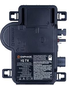

The high-powered smart grid-ready Enphase IQ 7X Micro™ dramatically simplifies the installation process while achieving the highest system efficiency for systems with 96-cell modules
The Enphase System is flexible, so you can design a system to fit today's budget and energy needs, and expand it later as your needs evolve. Want to add more panels, or a solar battery? With micro-inverters, it's no problem.
  • Optimized for high powered 96-cell modules
  • Max Continuous Output Power: 315 VA
  • Recommended PV module input power: 320-460+ W
  • MPPT Range: 25V – 79.5V
  • Min/Max start voltage: 33V / 79.5V
  • 97.0% CEC Efficiency (@ 240VAC)
