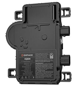

Enphase IQ8H-240-72-2-US Micro Inverter 240 Volts AC With MC4 Connectors For 72 Cell Modules
IQ8H-240-72-2-US
Note: This micro inverter is discontinued, Please look at the Enphase IQ8HC-72-M-US.
Enphase IQ 8H Micro Inverter With MC4 DC Input Connectors
Enphase newest IQ8 Microinverters are the industry's first grid-forming microinverters with split-phase power conversion capability to convert DC power to AC power efficiently. The brain of the semiconductor-base microinverter is enphase's propriety application-specific integrated circuit (ASIC) which enables the microinverter to operate in grid-tied or off0drid modes. this chip is built in advance 55nm technology with high speed digital logic and has super-fast response times to changing loads and grid events. alleviation constraints on battery sizing for home energy systems.
  • Optimized for high powered 60-cell/120 half-cell, and 72-cell/144half-cell modules
  • Max Continuous Output Power: 384 VA
  • Recommended PV module input power: 295-540+ W
  • MPPT Range: 38V – 45V
  • Min/Max start voltage: 30V / 58V
  • 97.0% CEC Efficiency (@ 240VAC)
Easy to Install
  • Lightweight and compact with plug-n-play connectors
  • Power Line Communication (PLC) between components
High productive and reliable
  • Optimized for latest high powered 60-cell/120 half-cell, and 72-cell/144half-cell modules
  • More than a million cumulative hours of testing
  • Produce power even when the grid is down
Grid-forming
  • Complies with the latest advance grid support
  • Remote automatic updates for latest grid requirements
  • Configurable to support a wide range of grid profiles
  • Meets CA Rule 21 (UL 1741-SA) requirements
Mechanical Data
  • Weight: 1.08 kg (2.38 lbs)
SKUIQ8H-240-72-2-US
