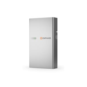

The IQ Battery 5P all-in-one AC-coupled system is powerful, reliable, simple, and safe. It has a total usable energy capacity of 5.0 kWh and includes six embedded grid-forming microinverters with a 3.84 kVA continuous power rating. It provides backup capability and installers can quickly design the right system size to meet the customer needs.

  • Provides 3.84kVA continuous and 7.68kVA peak power
  • Doubles the available power per kWh of prior generations of IQ Battery
  • Includes six embedded IQ8D-BAT Micro-inverters
Reliable:
  • 15 years limited warranty
  • Cools passively with no moving parts or fans
  • Uses wired communication for fast and consistent connection
  • Updates software and firmware remotely
Simple:
  • Fully integrated AC battery system
  • Installs and commissions easily
  • Supports Backup, Self-Consumption, and time-of-use (TOU) modes
  • Offers homeowners remote monitoring and control from the Enphase App
  • Field replaceable components
Safe:
  • Evaluated to UL 9540A for large scale fire testing and reduced separation distance as required in 2021 IRC R328.3.1, 2021 IFC 1207.1.5, and 2023 NFPA 855 15.3.1 and 9.1.5
  • Uses lithium iron phosphate (LFP) chemistry for maximum safety and longevity
  • AC output: 240/211-264 VAC
  • Continuous output power: 3.84 kVA
  • Peak output power: 6.14 kVA (10 seconds)
  • AC frequency: 60 Hz
  • Output current: 16 Amps
  • Peak output current: 25.6 Amps (10 seconds)
  • Maximum units per 20 A branch circuit: One units (single phase)
  • Battery capacity: 5.0 kWh (usable capacity: 5.0 kWh)
  • Battery chemistry: Lithium iron phosphate (LFP)
  • Unit dimensions: 38.6 in x 21.7 in x 7.4 in
  • Total weight: 78.9 lbs.
  • Maximum altitude: 8,200 feet
