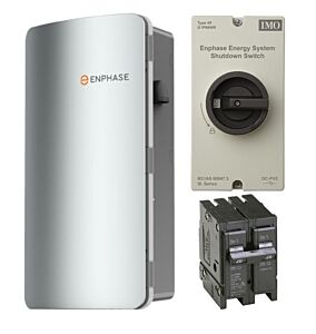

Enphase Power Kit Including an IQ System Controller 2 and Rapid System Shutdown Switch
Enphase power kit with a IQ System Controller 2 and RSD switch
The Enphase IQ System Controller 2 connects the home to grid power, the IQ Battery system, and solar PV. It provides microgrid interconnection device (MID) functionality by automatically detecting and seamlessly transitioning the home energy system from grid power to backup power in the event of a grid failure. It consolidates interconnection equipment into a single enclosure and streamlines grid independent capabilities of PV and storage installations by providing a consistent, pre-wired solution for residential applications.
Each Enphase Storage system with IQ8 PV requires the presence of a rapid shutdown (RSD) switch. Rapid shut down switch is needed to disconnect all PV panels, battery and generator systems in the building/home to ensure the safety of maintenance technicians. When the RSD switch is engaged, the Enphase storage system will be shutdown and the home is connected to the grid

Kit Includes:
- IQ System Controller 2 (EP200G101-M240US01)
- RSD switch (EP200G-NA-02-RSD)
- Breaker for IQ Gateway pre-installed in generator spot of IQ System Controller (BRK-20A-2P-240V)
- 20 ft of color-coded wires (along with corresponding color-coded labels) to improve installation experience
