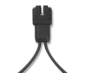

Enphase Q-12-10-240 Single Connection Q Trunk Cable For 60/72 Cell Modules in Portrait Orientation
Q-CUT-PORT-01
$22.29
IQ Trunk Cabling - 240 Volts for Portrait Orientation
NOTE: This cable is sold by the total number of inverter connections you need. The cable will be cut as a single length of cable with the number of inverter connections you specify as the quantity.
Enphase Q cable single inverter connection cable for portrait orientation. Connector spacing is 4.2 feet.
The Enphase Q Cable is a lighter weight, distributed generation cable with pre-installed connectors that support faster, simpler, and more reliable installations.
  • 2-wire cable is 50% lighter than previous generation Enphase cable
  • New cable numbering simplifies wire management
  • Plug-and-play connectors speed up installation
  • More cost-effective with less cable waste
  • UL listed
  • Rated for up to 600 Volts (connector rating 250V)
  • Cable temperature rating: 90° C (194° F)
  • Certification: UL3003, DG cable
  • Flame test rating: FT4
  • Compliance: RoHS, OIL RES I, CE, UV resistant, combined UL for Canada and United States
  • Cable insulator rating: THHN/THWN-2 dry/wet
SKUQ-CUT-PORT-01
