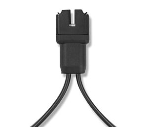

Enphase Q cable single inverter connection cable for landscape orientation. Connector spacing is 6.5 feet.
The Enphase Q Cable is a lighter weight, distributed generation cable with pre-installed connectors that support faster, simpler, and more reliable installations.
