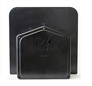

EZ Solar Rooftop PV Junction Box - Asphalt Shingle - Made from advanced durable polycarbonate. EZ Solar believes innovations is key to making Solar Simple! The most revolutionary junction bos on the market just got better! Designed with the installer in mind, the JB-1.XL makes installation fast and easy.
Made from advanced durable poly-carbonate - 3 layers of water protection - 2 weep holes for breath-ability - UL1741 - NEMA Type 3R - Includes pre-installed DIN rail - Rated to 1000VDC at 120 amps - Roof Slope Range: 2.5 – 12:12
Cost Effective
  • Larger box at a lower cost
More Space
  • Made from advanced durable poly-carbonate + superior components, UL1741, Type 3R
  • 3 patented layers of water protection
  • 2 Weep Holes for breath-ability
High Quality
  • Enter through 3 Side Walls
  • Minimal Shingle Cutting
  • Din Rail Pre-installed
  • Maximum Voltage: 1,000 Volts
  • Maximum Current: 120 Amps
  • Allowable Wire: 14 AWG – 6 AWG
  • Spacing: Please maintain a spacing of at least ½” between uninsulated live parts and fittings for conduit, armored cable, and uninsulated live parts of opposite polarity.
  • Enclosure Rating: Type 3R
  • Roof Slope Range: 2.5 – 12:12
  • Max Side Wall Fitting Size: 1”
  • Max Floor Pass-Through Fitting Size: 1”
  • Ambient Operating Conditions: (-35°C) - (+75°C)
