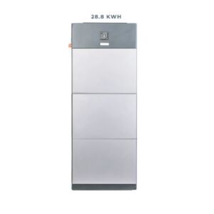

The Fortress Power eForce 28.8 kWh Lithium Iron Phosphate (LFP) battery is a modular energy storage solution designed for durability and efficiency. Each unit offers 9.6 kWh of energy capacity and features a built-in temperature sensor-controlled heating system, ensuring optimal performance across various weather conditions.
The eForce batteries are stackable, allowing up to three units per stack and a maximum of 16 units per system, achieving a total energy storage capacity of up to 153 kWh. This design eliminates the need for interconnecting cables within the stack, as the battery terminals click into place, simplifying installation and reducing costs.
Each eForce stack is complemented by the eWay, a designated wireway that contains busbars to connect the eForce battery stacks and the Envy True 12kW inverter(s). The eWay also features conduit entrance ports of various diameters, an emergency switch, and an LED display that shows the battery stack status in real-time.
Key Features:
  • Modular and Scalable: Stack up to three units per stack and up to 16 units per system, reaching a total capacity of 153 kWh.
  • Efficient Installation: Eliminates the need for interconnecting cables within the stack, reducing installation time and costs.
  • All-Weather Performance: Built-in temperature sensor-controlled heating ensures optimal operation in diverse climates.
  • Integrated Monitoring: The eWay provides real-time status updates and simplifies system connections.
  • Energy Capacity: 28.8kWh
  • Nominal Voltage: 48V
  • Weight: 681 lbs
  • Dimensions: 24.4 x 9.4" x 72.9 in
  • Operating Temperature Range: -4 - 140 F
  • Ingress Protection Rating: 65
The eForce 28.8 kWh LFP battery is ideal for residential and commercial applications, offering a reliable and scalable energy storage solution. It comes with a 10-year warranty, ensuring long-term performance and peace of mind.
