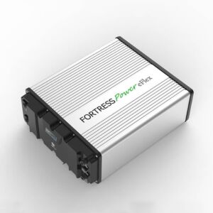

Fortress Power eFLEX 5.4 kWh LiFePO4 Battery
This kit is the eFLEX 5.4 G2 version that comes with the wall mounting brackets.
Fortress Power announces the eFlex 5.4 kWh scalable energy storage battery solution. The unit uses safe and high energy density prismatic Lithium-Iron-Phosphate cells. The battery has a built-in data storage and Wi-Fi for remote monitoring and troubleshooting ability. The smart relay-based Battery Management System (BMS), supports closed-loop communication with various 48V hybrid inverters on the market. Additionally, the BMS monitors and balances the voltage and temperature of each individual cell to maximize reliability and longevity. It has the highest round trip efficiency in the industry at 98%. This unit has wall mounting functionality and fits well into standard server racks for large systems.
