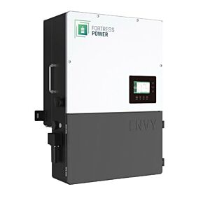

If you are looking for a complete inverter solution for your whole home, you might want to check out the Fortress Power Envy 10kW. This inverters can work with the Fortress Power eFlex 5.4 kWh, the eVault MAX 18.5 kWh or LFP-10 MAX batteries to provide you with up to 10kW of backup power for your entire house. The inverter also have a 90A AC passthrough that lets you connect to the grid or a generator when needed. The Envy inverters have 2 MPPT outputs that can support a solar array of up to 13 kW or 15 kW, depending on the model. They also come with a built-in rapid shutdown transmitter and button, as well as integrated AC & DC breakers for easy installation and safety. You can monitor and control your system from anywhere using the online monitoring app. The Envy inverters are the ultimate all-in-one solution for your home energy needs.
  • 2MPPT Output for max 15kW PV Array
  • AC / DC Coupling
  • IP65 rated for indoor & outdoor installation
  • Built-in generator port
  • 10 units in parallel
  • Online monitoring/app
  • Color LCD touch screen
  • Max. DC Input Power for Single MPPT: 6000W/6000W
  • Max. PV Input Power: 15000W
  • Max. PV Power Delivered to Battery & AC Outputs: 12000W
  • DC Input Voltage Range: 100V-600V
  • Nominal DC Input Voltage: 360V
  • Full Power MPPT Voltage Range: 210V-500V
  • Max. DC Input Current: 25A/25A
  • MPPT Number/(Strings per MPPT): 2/2
Output/Input AC (Grid)
  • Continuous AC Power to Grid: 10000W (240V)
  • Continuous AC Power to Load with Grid or Generator: 21000W (240V)
  • Nominal Output Voltage: 120V/240V
  • Max. Continuous AC Current: 41.6A @ 240V
  • Nominal AC Frequency: 50Hz/60Hz
Output AC (Off-Grid)
  • Max. Output Power: 10000W (240V)
  • Nominal Output Frequency: 50Hz/60hZ
  • Nominal Output Current: 41.6A @ 240V
  • Peak Power: 20kW 500ms
Battery Parameters
  • Compatible Battery Type: eVault Max, eFlex, LFP-10 MAX
  • Nominal Battery Voltage: 48V
  • Battery Voltage Range: 40V-60V
  • Maximum Charging/Discharging Current: 210A
  • Maximum Charging/Discharging Power: 10000W
