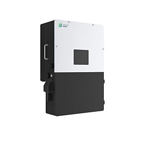

The Fortress Power Envy 12kW inverter is a whole-home, all-in-one inverter solution. Paired with the Fortress Power eFlex 5.4 kWh, the eVault MAX 18.5 kWh or LFP-10 MAX batteries, the Envy features a 200A AC passthrough providing up to 12kW (50A @ 240V) of whole-home backup power. The Envy features a built-in generator input with AC/DC coupling, on- and off-grid capabilities, plus a 3 MPPT output allowing for a maximum of 21 kW PV array. The Envy is equipped with a built-in APsmart Module Level Rapid Shutdown Transmitter and Button, along with Pre-built AC & DC breakers allowing for fast installation and commissioning. Use our online monitoring app to access your system from anywhere.
