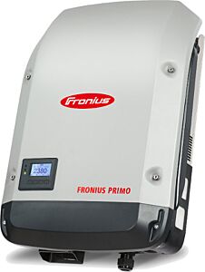

Fronius Primo 6.0-1 6,000 Watt Residential Solar Grid-Tie Inverter
Fronius Primo 6,000 Watt, non-isolated string solar grid-tie inverter.
