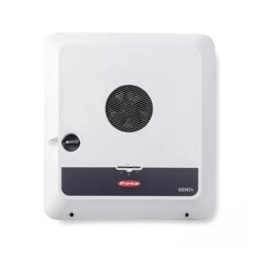

Fronius Primo GEN24 6.0-208-240 6kW single phase string inverter.
The Fronius GEN24 serves as the core of your PV system, offering the flexibility to use your self-produced solar energy even during power outages. This European string inverter stands out with its cutting-edge technology and smart solutions, saving you both time and money.
The built-in basic backup power function, PV Point, ensures that essential household loads are supplied via a socket during a power failure. The Fronius GEN24 also maintains efficient energy generation even in shading conditions, thanks to its integrated software. With less effort for greater yield, the Fronius GEN24 is designed to empower.
Integrated Shade Management
Eliminate shading issues with ease. The Dynamic Peak Manager in the Fronius GEN24 inverter detects any shading on the PV modules and optimizes the yield at the string level, removing the need for additional module-level optimization components.
Backup Power Right from the Start
Enjoy peace of mind with backup power directly from the sun through the PV Point. This integrated solution ensures that essential devices in your household can be powered during a grid outage, using sunlight to keep you running even without a battery.
Built-in Longevity
Keep cool and save money with the Fronius GEN24's Active Cooling Technology. This feature maintains the power electronics at consistently low temperatures, ensuring a prolonged lifespan for the inverter and reducing maintenance costs. The Fronius GEN24 stands out as a reliable and cost-effective choice.
  • Number of MPP trackers: 2
  • DC input voltage range: 65-600V
  • Nominal input voltage(208Vac, 220Vac, 240Vac): 360 , 380, 400
  • Usable MPP voltage range: 65-350V
  • MPP voltage range (at rated power): 200-480V
  • Max. usable input current (Idc max): 22A (MPPT1), 12A(MPPT2)
  • Max. short circuit current per MPPT: 36A (MPPT1), 19A(MPPT2)
  • Number of DC connections: 2
  • Max. usable DC power: 6,190W(MPPT1), 6,190W(MPPT2), 6,190(Total)
  • Max. PV generator output: 8,000Wpeak(MPPT1), 6,800Wpeak(MPPT2), 9,000(Total)
  • AC rated power (Pac,r) (208Vac, 220Vac, 240Vac): 5,740W, 6,000W, 6,000W
  • Apparent power (208Vac, 220Vac, 240Vac): 5,740W, 6,000W, 6,000W
  • Max. Output power (208Vac, 220Vac, 240Vac): 5,740W, 6,000W, 6,000W
  • Nom. AC output current (208Vac, 220Vac, 240Vac): 27.6A, 27.3A, 25A
  • Dimensions (height x width x depth): 20.4 x 18.7 x 6.5 inches
  • Weight: 33.24 lbs.
