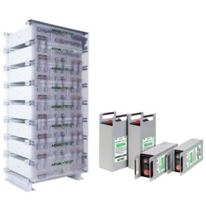

GNB Industrial 2040Ah 2VDC VRLA Battery
The Absolyte GP battery is of the valve-regulated lead-acid (VRLA) design and so can operate with lower maintenance (e.g. no maintenance water additions) in comparison to conventional flooded lead-acid batteries. The Absolyte GP VRLA design is also inherently safer than conventional flooded lead-acid batteries. Under normal operating conditions and use, the Absolyte GP battery minimizes hydrogen gas release, and virtually eliminates acid misting and acid leakage.
Features & Specifications:
  • Battery Voltage: 2 Volts DC
  • Total Amp-hours @ 20 hour rate: 2040 Amp-hours
  • Total Amp-hours @ 100 hour rate: 2370 Amp-hours
  • Weight: 328 pounds
  • Dimensions (L x W x H): 19.93" x 26.38" x 8.59"
  • Electrolyte – 1.310 specific gravity acid (nominal)
  • Safety vent – 3-10 psi opening pressure, self-resealing
  • Terminals – Solid copper insert
  • Positive plate – Patented lead calcium tin silver alloy
  • Negative plate – Lead calcium grid alloy
  • 20 years design life in float applications at 25°C (77°F)
  • 1200 cycles to 80% DOD at 25°C (77°F)
  • Operating temperature – Temperature excursions between -40°C (-40°F) to +50°C (122°F) allowed (battery performance and life will be affected)
  • Self-discharge – 0.5 to 1% per week maximum @ 25°C (77°F)
  • Float voltage – 2.23 to 2.27 Volts per cell
