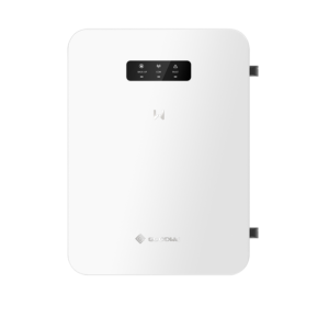

GoodWe ABD200 for ES-US/SBP-US full backup when off grid
The Automatic Backup Device (ABD) works seamlessly with GoodWe ES-US and SBP-US inverters to enable whole-home backup for North American homeowners. Equipped with an integrated North American Smart Meter, it supports up to four CTs for high-precision monitoring of household appliances—offering more accurate insights than many other solutions.
Goodwe ABD (Auto Backup Device) is needed to be used with ES-US20 inverter to provide backup power during a power outage. Without ABD installed the Hybrid inverter/ battery bank can only operate when utility grid power is present.
Benefits:
  • 24/7 Whole Home Backup
  • High precision of load monitoring
  • Perfect compatibility with ES-US & SBP-US
  • Low voltage ride through
Electrical Data
  • Nominal Output Voltage (V): 240
  • Output Voltage Range (V): 211 - 264
  • Feed-in Type: Split Phase
  • Nominal AC Voltage of Line Conductor (V): 120/240
  • Nominal AC Frequency (Hz): 60
  • AC Frequency Range (Hz): 58.5 ~ 61.2
  • Current Rating (from Grid)(A): 200
  • Max. Continuous Current from Inverter (A): 32
  • Maximum Overcurrent Protection of Main Breaker (A): 200
  • Maximum Overcurrent Protection of Circuit Breaker of Inverter (A): 40
General Data
  • Operating Temperature Range: -13°F ~ 140°F (-25°C ~ 60°C)
  • Max. Operating Altitude: 9842ft (3000m)
  • Cooling Method: Natural Convection
  • Communication with Inverter: RS485
  • Weight: 26lb (12kg)
  • Dimension (W × H × D): 17.7 × 24 × 5.9 in (450 × 610 × 150 mm)
  • Mounting Method: Wall Mounted
  • Ingress Protection Rating: Type 3R, IP44
