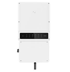

The A-MS is an inverter of the highest quality and GoodWe takes great pride in it. This product was conceived to be a solid element of your residential array for the long term. Put your faith and confidence in its quality, its extended warranty of 10 years and GoodWe will be on your side for any issue along the way.
Integrated AFCI & Rapid Shutdown:
The A-MS has been designed to meet the safety regulations of the American market, including Arc Fault Circuit Interrupter and Rapid Shutdown. GoodWe does not only deliver efficiency, reliability, but security as well.
High Power Generation:
This inverter goes with the trends of the North American residential market and is compatible with bifacial modules. It also has the capacity to take as much as 12.5 A per string. These features ensure that the A-MS can absorb more solar power and make it one of the most productive inverters on the American residential market. With 150% DC input oversizing capability, the A-MS allows end-users to significantly expand the solar array and drive increased power output even under low solar radiation.
- Max. Input Voltage(V): 600
- Max. Input Current per MPPT(A): 12.5 / 12.5
- Number MPP trackers/Number of Strings per MPPT: 2/1-1
- Weight (lbs): 62.8
- Nominal Out Voltage (V): 211 to 264 @ 240 / 183 to 229 @208
